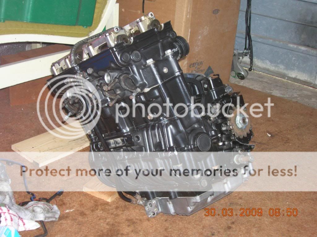

that large round cover with the window in is the cluch cover, even if you remove it youll have to lay the bike on its side as the oil is much lower than the bottom of that cover. if you remove the bottom fairing youll find the pipes will have a joint just behind the bottom of the down pipes near the front of the engine, if theres no joint at the front of the engine there is a bolt on the cluch side with 2 hoses atached leading up to the front of the engine. this would be the next best place to drain it from though you might have to flick the starter button as this will be pumped out rather than drained out. you can see the area on the pic below.
