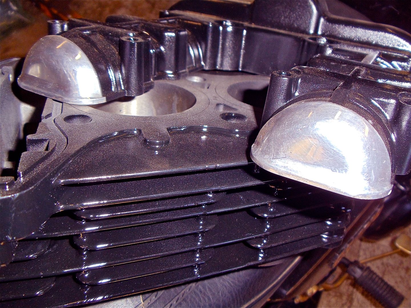

I just did this cylinder a few days ago. Bon appetite!![]() ![]() Here is a pic of my Z1 parts. (Dusty) ![]() Eric Edited by 67fire, Mar 25 2014, 05:34 AM.
