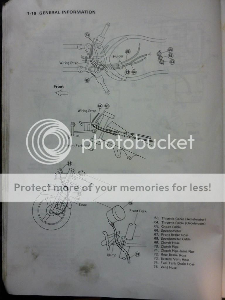

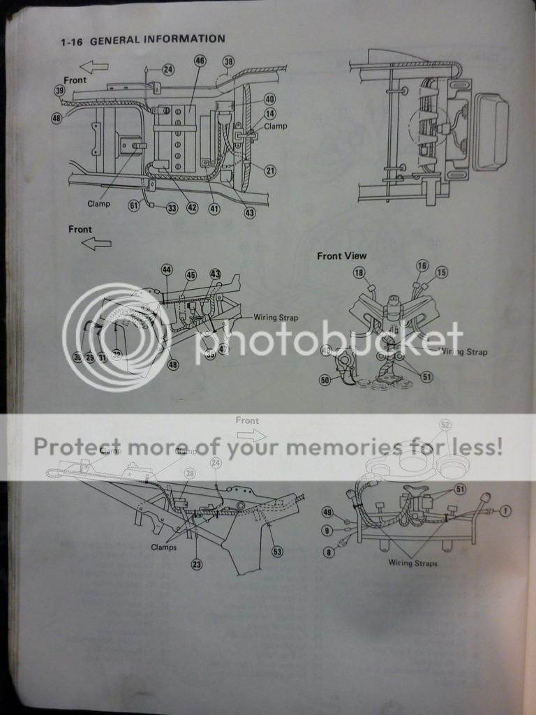

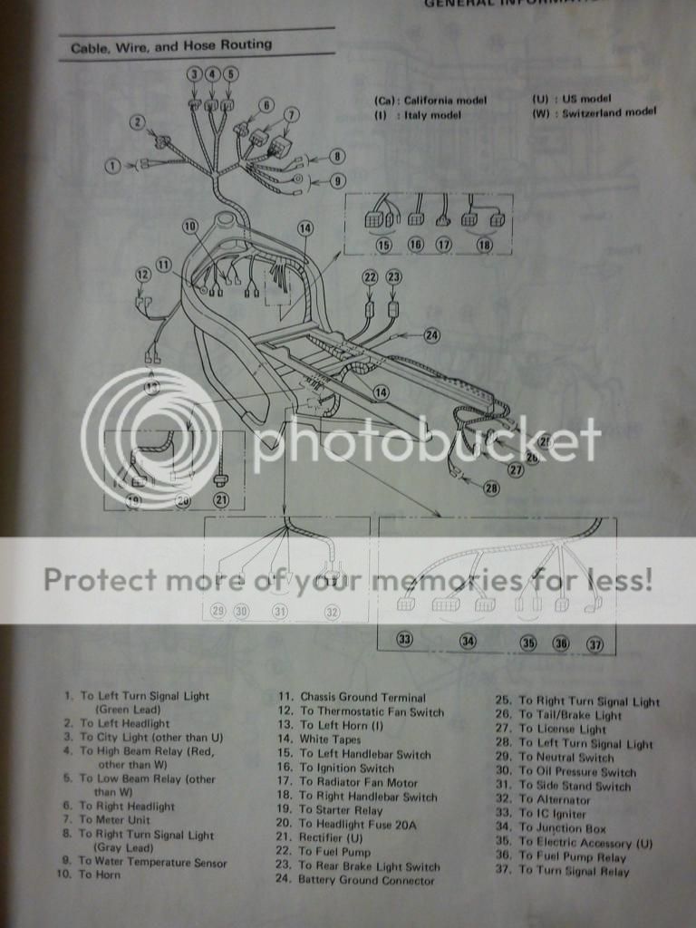

Hi i'm looking for a little help with my zxr 750 h1 nut & bolt rebuild (project). I am just looking to see if anyone has any pictures or diagrames of the wiring loom route through the frame. Any help would be great. Thanks. |

hi walker54zxr im at work at the mo but when i get home tonight ill pop up some pictures of what your after i have the workshop manual regards harry

hi walker as promised ![]() ![]() ![]() ![]() ![]() need any more help just ask bud regards harry |

Thank you harry these will do brilliantly the wiring loom was the only holding the build up but not now. Thanks Stuart. |
